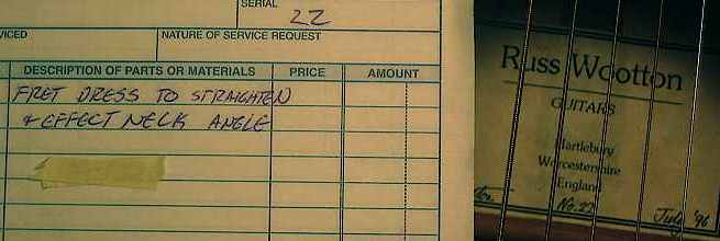

Here's a small bodied 12 fret in my shop right now. I'm not sure what non-
adjustable reinforcement was used, but it has a spanish heel to boot.
My focus is in repair and maintenance, so naturally my emphasis is on
serviceability and adjustability. I hold a very firm philosophy that if you want
an instrument to be around for 50 or 100 years then movement and settling
of all parts should be anticipated in the design. Of course a non-adjustable
neck is never really non-adjustable, it's just not as convenient of an
adjustment. For this I guess it's a judgment call on the part of the builder
and buyer, but I find the ability to make even minute adjustments invaluable
to fine tuning a setup for a particular player.
